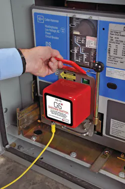

Solid return-to-service plans also utilize proper safety-related work practices. The plan should specify the appropriate personal protective equipment (PPE). When PPE is not sufficient, portable remote racking and control solutions are an alternative, as they mitigate not only the thermal effects of an arc blast but also the hazards of shrapnel, vaporized metals, and flying debris (see Figure 2).
Effective plans can also inventory and make workers aware of the safeguards already built into the facility, such as maintenance switches that temporarily lower breaker settings or permanently installed remote controls.
