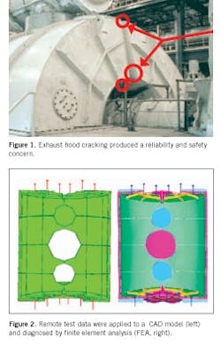

A power plant in Asia was experiencing high vibration and cracking in the exhaust hood of a critical large low-pressure steam turbine (Fig. 1). The typical troubleshooting approach Mechanical Solutions Inc. (MSI, www.mechsol.com) uses in such situations is to travel to the site of the machinery, collect the data, analyze it and recommend a fix. However, in this case, such a trip might have jeopardized company personnel in an area where insurgents and bird flu were threatening, so a remote problem-solving approach was implemented.

The combined test and analysis model identified a dangerous, running-speed resonance of a natural frequency of the exhaust hood that involved synchronous motion at both ends close to the turbine operating speed. It furthermore proved that the structural natural frequency coupled with an S-shaped rotor natural frequency that was supposed to be comfortably above running speed, but instead was resonant, causing a feedback relationship that led to enough motion to crack the casing at the problem locations.
Figure 2 shows the motion of the natural frequency combination. A mistake in the alignment between the turbine and generator, which would have normally resulted in minor vibration increase, was driving the rotor mode, which, in turn, was driving the bearing housing, which drove the exhaust hood casing motion. The swaying structural motion reinforced the rotor second bending (S-shaped) mode shape, completing the dangerous cycle.
The ends of the exhaust hood were stiffened with thick, bolt-on support ribs, and thick metal plating across the casing ends. The vibration was dramatically reduced, and the cracking stopped for the first time in several years. Costly trial-and-error problem-solving was avoided by the rapid-response and low-cost approach, allowing the plant to get back to what it does best: producing megawatts for an electric-power-hungry region of the world.
