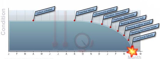

Jason Tranter, founder of Mobius Institute, takes that concept further. “Without an understanding of the failures modes, including an appreciation of the P-F interval (the time from first symptom to functional failure), it is not possible to determine which PdM technology can detect the fault or how frequently tests must be performed,” says Tranter.
Figure 1. Some technologies provide earlier warnings than others. Source: Mobius Institute

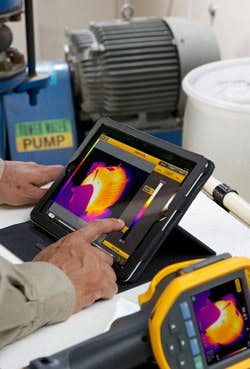

“Thermography offers great amounts of detail in reasonably short periods of time without physical contact with the equipment," explains Michael Stuart, senior manager of thermography services at Fluke. "Vibration analysis enables earlier detection and diagnoses problems, although it requires direct contact with the equipment. Motor testing is one of the most common forms of reactive testing, but it can be incorporated into a more proactive program.”
Figure 3. Thermography offers great amounts of detail in reasonably short periods of time without physical contact with the equipment. Source: Fluke

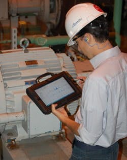

“The internet and cloud-based PdM solutions are becoming valuable tools to deliver not only asset health information, but process information as well,” remarks LUDECA's Leach. “The data can be accessed from almost anywhere and configured so that only those with the proper access can see or manipulate the information.”
