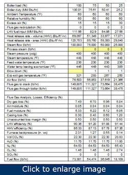

Table 1. Boiler performance varies as a function of the load.
The first step is to understand the load-versus-efficiency characteristics of a typical package boiler. Table 1 shows performance variation as a function of load. The boiler with an economizer generates 100,000 lb/h of saturated steam at 400 psig using natural gas. At 100% load, the exit gas temperature is 320 °F. Excess air is 15%. The various losses (per ASME PTC 4.1) are shown along with the efficiency.
The efficiency variation isn’t much with load. The casing loss is a function of casing temperature, wind and ambient conditions and doesn’t change with load. Hence, efficiency as a percentage of boiler duty will be smaller at higher loads, and vice versa. The flue gas losses on the other hand will be greater at greater loads as the exit gas temperature is greater at greater loads and decreases as the load decreases.
The combination gives a somewhat flat or parabolic performance curve (Figure 3). The efficiency on a lower heating value (LHV) basis increases slightly from 91.44% at 25% load to about 60% load and then tapers off. To determine burner duty, divide the boiler duty by the efficiency. Using a performance sheet obtained from a boiler supplier, one can get an idea of the fuel consumption at any load.

At 50% load, the steam generation is 50,000 lb/hr, and additional boiler duty is 24.9 million Btu/hr compared to the unfired condition. However, we are consuming only about 24 million Btu/hr (LHV basis) fuel to generate this steam. This implies that fuel efficiency is more than 100%. If we generate the same additional 25,000 lb/hr steam in a steam generator, the additional fuel input (Table 1) is about 27.2 million Btu/hr on LHV basis. Another way to look at the efficiency of both boiler types is this: The HRSG generates an additional 75,000 lb/hr of steam with a fuel input of only 75.6 million Btu/hr (subtract the fuel input at 100,000 lb/hr steam from the unfired case steam generation). The package boiler, on the other hand, requires 84 million MM Btu/hr (111.6-27.56). Hence, the HRSG can produce steam with about 8% to 10% less fuel input.
