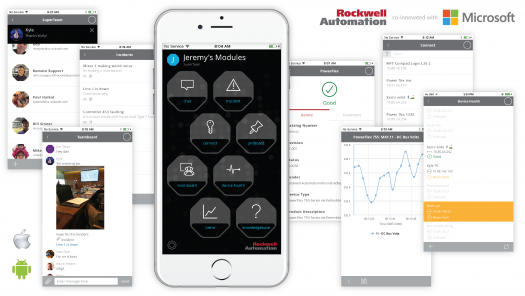

“Project Stanton’s main goal is to increase productivity by 33 seconds per hour instantly for every industrial role with zero friction.” Source: Rockwell Automation

Rockwell Automation and Microsoft’s co-innovation project addresses industrial environments where a wireless network connection is not always reliable. “Project Stanton’s main goal is to increase productivity by 33 seconds per hour instantly for every industrial role with zero friction. This means to break through all the technical barriers to value, and focus on enabling collaboration between people and devices in a secure and progressive way,” says Kyle Reissner at Rockwell, IA Mobility Platform Leader at Rockwell Automation.
The project has driven a new extensible app platform, built for industry, that enables customers to use it right away, realize what mobile can do for them, and then go after new use cases using the platform to drive more productivity improvements. “Don’t just buy technology for technology’s sake,” cautions Reissner. “We all need to focus on the value outcome and identify even the small opportunities – like ones that save 33 seconds per hour per employee – because those add up when applied to the entire plant. We believe our new app platform on company or personally owned devices can do this.”
Another distinction of Project Stanton is that customers do not need to connect their assets, controllers, drives, or automation systems to the cloud to get mobile. “Traditionally, customers are required to do this in order for anything to be delivered to a tablet or phone,” explains Reissner.
