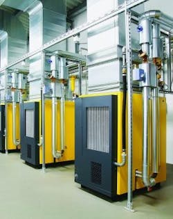

Ducting and tapping into the fluid circuit of compressors is an excellent way to utilize a compressor as a heat source and reduce operating costs.

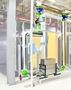

When dealing with existing systems, many compressors can be retrofitted with external heat exchangers for heat recovery.
To turn the potential savings into real savings requires a few planning steps. First, collect data. Determine how heat is generated in the facility. Calculate the annual cost of heating water and heating air. Calculate the annual energy cost of the compressors in the system. Compare these two numbers. The best savings potential will be in facilities where the cost of heating water and air exceeds the cost of running the compressors.  Where the cost of running the compressors exceeds the cost of heating water and air, less savings will be possible because the compressors are generating more heat than is being used in the facility. Still, much of the heating cost can be offset by recovering the heat from the compressors.
