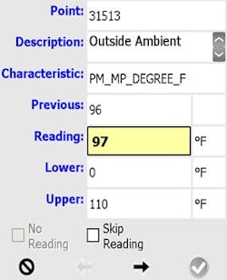

“Our hydro plant operators use the mobile solution for daily, weekly, and monthly safety, security, and operational inspections,” says Amber Osterman, business analyst at NorthWestern Energy’s Business Technology Department. “Over a month’s time period, we gather about 15,500+ reading documents. That is about 500+ readings per day for 11 plants.”
Figure 1. NorthWestern Energy hydro plant operators use the mobile solution for inspections.
The handheld devices contain client software that synchronizes with NorthWestern Energy’s enterprise asset management (EAM) system. “The operators pick their inspection list for the day, walk through their routes with the device in hand, and check off their inspection points as they are completed. The tasks are presented in the order that they do their rounds,” explains Osterman. “It’s a disconnected device, so when they’re finished with their rounds, they dock their device via a USB port, and the data is transmitted.”

Figure 3. NorthWestern Energy gathers about 500+ readings per day for 11 plants. Source: NorthWestern Energy
