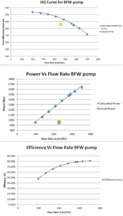

You can develop a head-flow Excel graph similar to Figure 1. You can color-code the preferable and the allowed operating regions from the best efficiency point (BEF) as per API 610 requirements on the pump curve. The real-time data point can then be imported into Excel and subsequently shown on the graph as described in the study giving a good and easy visual of where a particular pump is operating relative to the pump curve. Pumps operating beyond the allowable margin can be addressed at the soonest available interval. Pumps in the allowable margin can be studied further and related with their overall vibration limits and seal reliability, and an effort can be made to operate such pumps in the preferred region.

Step 2: Generate the appropriate graphs in excel required to monitor the performance of the pump (Figure 1).
Figure 1. Generate the appropriate graphs in excel required to monitor the performance of the pump.

This crucial step integrates all the available information to efficiently monitor the equipment. Figure 1 shows the H-Q and power curves. These curves have been incorporated with real-time information showing the pump TDH flow and pump hydraulic power, respectively. This helps to present the real-time pump operation relative to the actual operation of the pump during performance test at the test bed after manufacturing. Visual presentation of this information helps to understand how far the pump has moved away from the actual operating point during normal plant operation. It also helps to estimate operating power losses as a result of drop in pump operating efficiency.
