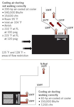

Methods of heat recovery: Air-cooled units usually try to collect all the air in one airstream and then duct the heated air as required to a desired location. This would be similar to the space heating and heat barrier examples shown (Figure 3). Note on the space heating sketch a booster fan has been added to ensure there is enough fan to move the cooling air without restricting the cooling air flow. When installing this ductwork, both intake and discharge, work closely with the service provider or installer or risk damaging the compressor from running too hot.

Space heating: Warm cooling air can be exhausted directly into the space to be heated or added to the main plant heating system. If the compressor cooling air exhaust temperature drops below an acceptable level or below the level of the main plant heating system (part load compressor operation results in less heat generated), a thermostat-activated control valve may be required. A booster fan will ensure it is warm enough before the air is bled in the area to be heated.

Figure 4. Check the performance of existing ductwork by tracing the temperature with a surface pyrometer.
Heat barrier: When mobile equipment or people move frequently into and out of a building, the temperature may fall to the discomfort of the occupant. A heat barrier can prevent this (Figure 4). The compressor cooling air exhaust is ducted between the two sets of doors, forming a continuous “lock” of warm air, inhibiting the outflow of warm air from the building. It is very easy to check the performance of existing ductwork by tracing the temperature with a surface pyrometer (Figure 5).
Figure 5. Ensure ductwork is working properly.

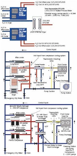

Water-cooled compressors: Heat recovery energy saving and projects are often much easier to implement with the heat well trapped in the controlled water flow. Regardless of the type of air compressor, the maximum expected heated discharge cooling water temperature is about 130 ˚F. The system layout is for two 220-bhp rotary screw compressors with a 2,500-scfm-sized water-cooled refrigerated air dryer (Figure 6). The expected energy recovery was almost $43,000/year based on heating the river process water up from the average temperature of 60 ˚F to a nominal 94 ˚F. This takes an energy load off the current natural gas heater system.
Figure 6. The system layout is for two 220-bhp rotary screw compressors with a 2,500-scfm-sized water-cooled refrigerated air dryer.
The total savings from this project was measured at $60,000/year due to the pre-cooling effect of the heat-reclamation heat exchanger loop on the primary 10-fan closed 60/40 polyglycol air-cooled cooling system. Only two fans ran most of the summer, and only one fan or less during colder weather.
