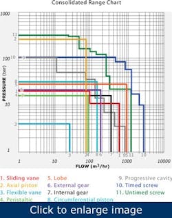

A consolidated range chart (Figure 3) depicts the flow and pressure envelopes of each rotary pump type. Given knowledge of the full range of application flow and pressure requirements, use the range chart to identify suitable rotary pump types. Consultation with the supplier is recommended to confirm specific application recommendations and to investigate special designs, which often are available to provide unique solutions.
Figure 3. The consolidated range chart maps the pump type to the process requirements.
