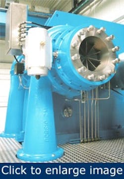

Figure 2. This is an example of an integrally geared centrifugal compressor for process applications.

Advantages of integrally geared compressor
They’re relatively new for process applications, in spite of a long history in auxiliaries such as air compression. The integrally geared configuration uses a main big gear to rotate several pinions, each coupled to one or two overhung centrifugal impellers. The pinion shafts can operate at different speeds, allowing each stage in a multi-stage machine to be run at its own optimum speed. Figure 1 and Figure 2 show integrally geared centrifugal compressors. Multi-stage integrally geared units handle many process gases in CPI plants (Figure 3).
It’s economically desirable to use the smallest possible machine. The head an impeller can develop depends on its pressure coefficient. Both efficiency and pressure coefficient are higher for semi-open overhung three-dimensional impellers, usually found in integrally geared machines. Semi-open impellers, have considerably higher pressure ratio capability, about two times to three times more than closed impellers.
Figure 3. This packaged integrally geared centrifugal compressor is an example of what might be found in a petrochemical plant.
This means integrally geared machines can reach an equivalent pressure using fewer impellers. Maximum tip speed of semi-open impellers, usually integrally geared, is about 30% more than a closed impeller. Variable guide vanes are the preferred method of capacity control to meet varying operating conditions (efficient part load operation). One of the main applications for integrally geared machines is small- and medium-size constant-speed motor-driven centrifugal compressors where a variable speed drive isn’t feasible.
