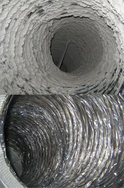

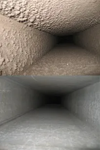

As air is drawn through an HVAC system, particulates gradually begin to collect on the interior of the ductwork, fan, fan housing, coils and other parts in contact with the air stream. As time goes on, the particles can coat the surfaces to a thickness of three inches or more. Although contaminant buildup usually isn’t more than 0.5 inches deep, sometimes it can be several inches. A two-inch buildup on the bottom of a 12 inch x 12 inch duct makes it a 10 inch x 12 inch duct. This narrowing of the flow area produces more resistance to air going through, adding to the energy bill. A Japanese study in the 1980s, however, found that when the contaminant coating thickness reac hes 0.03 inches, the particulates start to peel off and reenter the air stream.
HVAC systems get dirty over time, but at variable rates. Contaminant accumulation rates and peel-off rates are determined by a variety of factors, including duct size, air speed, air volume, particulate load in the air and particulate size. Some systems accumulate large amounts of debris and some reach a point of near equilibrium, where the rate of accumulation is only slightly higher than the rate of peel-off.

Replacing or repairing the air handler. When you change a fan, fan motor or the entire air handler, you shake the duct system and loosen the dirt inside it. A new fan likely will blow greater cfm than the old one, giving it enough strength to blast out lots of particulates that would have otherwise remained attached.
A poorly maintained HVAC system. If the filters have been missing or poorly fitted for six months or more, the likelihood is that the fan, coils and ductwork are laden with particulates and debris. A cleaning likely will be needed to give you healthy air output and coils that aren’t clogged.
Mold growth. This is more common in the South, but can be a problem anywhere. Biological growth inside the air handler can emit foul odors and can even make people sick. Mold growth inside the ductwork is less likely, but it can occur. Get mold contamination corrected immediately because failure to remedy it could open your company up to legal consequences.
Dirt blowing out. If system contamination reaches the point where dirt is coming out, covering machinery, desks or an employee’s lunch, you’ve probably hit a point of no return. The only remedy is cleaning the HVAC system thoroughly. Before you make the call, ensure the problem isn’t caused by something simple, like missing filters or an open door on the air handler.
Bad smells. Cigarette smoke, industrial fumes, particulates, algae, fungi, mold — a number of things can settle into a duct system, causing a rank odor when the system is running. We’ve found that the return ductwork is frequently the source of odors. It gets much dirtier than supply ductwork because it pulls in unfiltered air. Cleaning usually remedies this problem.
Dirty ducts or air handler. Sometimes you simply look at the system and common sense tells you it’s filthy and people shouldn’t be breathing air from it.
Air flow is restricted by dirt buildup. When enough particulates and debris collect in critical areas, it can cut air flow dramatically. Coils are a primary culprit because they have narrow air passages. These clog up quickly. Registers, particularly return registers with screen covers, also can become clogged.

Contact cleaning is the old-school method. The ductwork is hand-vacuumed. If the ducts are large enough, a technician crawls the interior. If not, the ducts are cleaned by cutting access holes every 15 feet or so, reaching in and vacuuming. Contact cleaning is the most thorough method but, because it can be more labor intensive (and thus more costly), it’s not used very often. However, even on some modern jobs, part of the work might require contact cleaning.
Negative-air-cleaning technology has been developed during the last 20 years. It involves a large vacuum (known as a negative-air machine) attached to a duct opening to produce a powerful draw of air through a section of ductwork. A variety of tools can be run through the duct while the vacuum is operating. Hoses can blast air and augers (long cables with a spinning brush on the end) can agitate the particulate into the air stream for the negative-air machine to collect.
Regardless of approach, industry best practices say that it’s insufficient simply to connect a strong vacuum up to the duct. Some kind of contact agitation, such as air blasting or mechanical brushing, is required on the interior duct surfaces to remove particulates more effectively. NADCA standards also dictate that either method must use vacuum devices equipped with high efficiency particulate air (HEPA) filters that catch particles as small as 0.3 microns.
