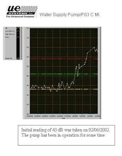

When trending bearings, it’s essential to establish an initial baseline reading. The first reading is my baseline. The best time to take the initial reading is when a motor, fan or pump is new.If the equipment has been in service for some time, you can still take your initial readings. If there’s more than one piece of identical machinery, compare the readings from each at the speed and under the same loading. Then, use the lower readings as your baseline. It doesn’t matter if the equipment is new or old, the important thing is to start a trending program. Some ultrasonic units have software that allows you to change the baseline after an overhaul or equipment replacement.

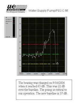

When I return to the office, I download the data into the software, which saves the readings, the date and time they were taken and the sound wave recordings. The software allows me to both hear and see the readings I took. Once I establish a baseline, I can trend the readings and compare each new reading to the previous reading and the baseline. A current reading that exceeds the baseline by eight decibels is a sign that the bearing lacks lubrication. At a difference of 12 decibels, you can expect minor damage and microscopic faults. When you reach a 16-decibel difference, damage is visually apparent. And a difference of 35 decibels or more indicates catastrophic failure.
Better software provides a choice of charts that you can graph: date, time, decibels, low-level alarm, high-level alarm, rpm, temperature, frequency and more. I normally set my low-level alarm at eight decibels over the baseline. My software automatically sets the high-level alarm at twice the low level.
The program allows us to watch what a particular piece of equipment is doing. We can adjust the alarm level to whatever suits our needs. If a reading exceeds the low-level alarm, the date at which it was taken turns yellow, alerting us that this is something to watch more closely. If the high-alarm level is exceeded, the date turns red, which also gets our attention.
When you locate a problem, initiate a maintenance request to repair the equipment. Including a trend chart in a report shows why a machine should be taken offline. And with trending, you can prove you didn’t miss something; you have the records to prove it.
After you make the repairs, take another set of readings to ensure the problem has been corrected and to reset your baseline. However, don’t delete your earlier data. It provides a valuable history. If a problem repeats, you can check the history. If the problem persists, you might decide, for example, that the application, not the bearing, is at fault.
