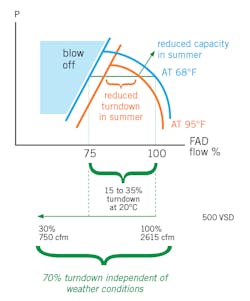

Frank Moskowitz (Phoenix, AZ):
VSD compressors have some really nice benefits. The performance chart (Fig. 1) shows typical power versus capacity when using a variable speed compressor. This shows almost perfect power turn down with flow.
  • Speed variation is brought about by a change in the supply frequency to the electric motor by the frequency convertor.
    1. The system is controlled by a pressure sensor mounted at the end of the air compressor package.
    2. This develops a 4-20 mA signal, which is first fed to the controls and compared to a setpoint.
    3. Depending on the signal, the communication is sent to the convertor to either increase or decrease the frequency to the electric motor.
    4. The VSD machine maintains the pressure within a band of about 2 psi and without pressure over-shoots.
  • VSD machines show a higher parts lifetime due to the absence of torque peaks and machine loading and unloading, but also due to lower average rpm than fixed speed machines.
    1. An example for bearings: Considering a fixed design constant C/P (bearing design constant) of 5000 for a bearing, for a fixed rpm of 2000, the bearing shows a lifetime of 50,000 hours. On the other hand, a machine running variable speed at an average 1000 rpm, the life of the bearing doubles.
  • A comparison to a Centrifugal compressors (Turbos):
  • Turbos operate in a stable condition in their turn down range being the zone between the operating point and surge. This is typically 15% to 35% depending on the ambient conditions. If stable pressure is to be maintained below the surge limit, blow-off is necessary.
  • VSD machines operate with a stable pressure down to about 20-30% (depending on make and model) of their rated capacity irrespective of ambient and with no blow-off.
  • This is a major energy saver.
